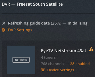

Did you do a manual EPG refresh through server settings for Live TV and DVR and allow that to complete? I can’t see what you have on your screenshot

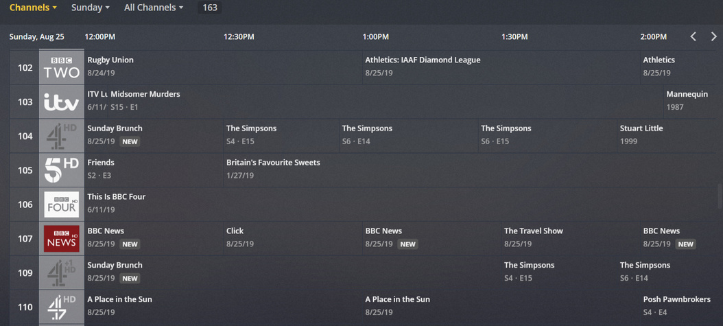

I had done a refresh; just checked this morning and the Unknown Airings have now shifted to MON starting from around 01:00.
Just did another manual refresh:
Now the EPG seems to be showing all programmes even beyond MON.
Yesterday, I hadn’t done a manual EPG refresh, but I had rebooted my Mac mini and noticed that Plex was doing a refresh already when I checked. This morning, I did a manual refresh.

EPG is looking good at the moment. I can see programme details up to SAT morning in a week.
@sa2000 - how many days should we actually see in the EPG?

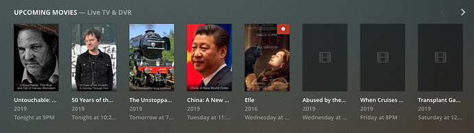

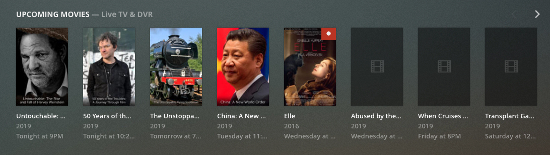

Upcoming Movies in UK freeview is still rubbish and broken
Issues over EPG have been going on for something like 2 months now - its getting ludicrous
Forget about new apps and tie ups with movie companies PLEASE get these basics corrected
Rant over
See pick below for my upcoming movies - EPG is littered with items which are listed as movies but are not movies. About 40% of the items listed are not movies
