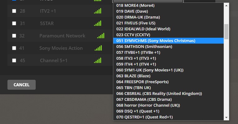

When I go to the tuner settings and go to the channels. That normally correspond to these channels . But In the drop down menu there is no corresponding channel to link it to.

When I took a look at the “Manage Channels” dialog I noticed channels 24 to 53 were not mapped to channels with guide data anymore.

I have tried to refresh guide and I have also tried to rescan for channels
After the scan when I try to link the scanned channels with the channels Plex knows about I do not have anything between 24 and 55.
Not sure if I will have to delete my DVR in plex and start again
Oh crap - To me that looks like Plex isn’t downloading the data for Channels 24 to 53 anymore :frowning:
Are you able to enable the channels on the left, but not map them to anything, then hit Save - at that point Plex should perform a guide refresh. I’m hoping it will download channels 24 to 53 - maybe worth a try before you delete your DVR from Plex.

After the refresh the channels like you suggested. once I go back into it they are unselected and there is no corresponding channel in the drop down menu.

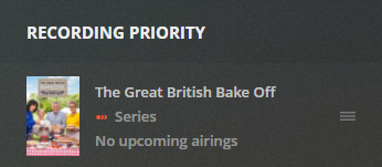

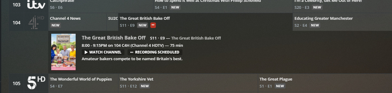

A new issue for me set to happen tonight
The Great British Bakeoff is in the EPG, it appears set to ‘New’, but the DVR Schedule is not picking it up. Even tried cancelling recording and setting it up again.
If I turn on ‘New and Repeat Airings’ it still doesn’t find the 9PM showing on either Channel 4 or Channel 4 HD
