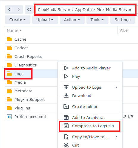

Also include a set of server log files. Login to the Synology. With File Station, go to /PlexMediaServer/AppData/Plex Media Server. There should be a Logs directory. Compress it, download, and attach the ZIP file to the thread (drag it into the window, it will upload).
