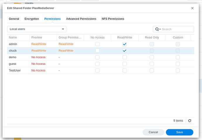

  2. Does Control Panel - Shared Folder show this except with your username?
    (both System Internal User and Local User dropdowns)
The drives are not healthy at the moment. They were earlier today. But as I was moving my Router, modem, UPS, and NAS; I removed the drives to clean out the nas with seeing a ton of cobwebs. There was a drive issue so I had to remove and reinstall then run the S.M.A.R.T. command per the storage suggestions.
When checking permissions i did see there was no checks in local users under my account for PMS. I tried running PMS again with no luck. Still runs, then stops.
