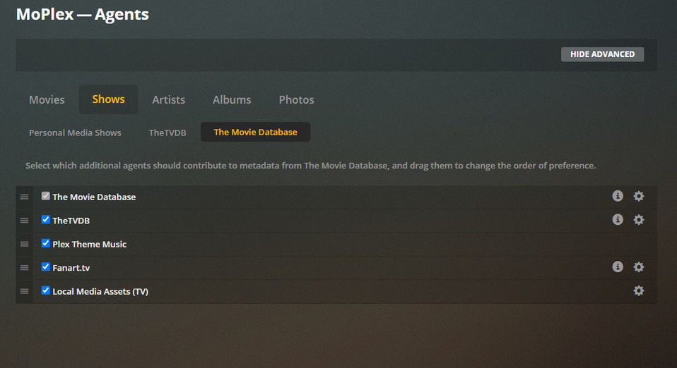

Then you may want to demote LMA for Shows and Movies (all tabs) so Plex will stop preferring embedded and bogus Title Fields in your MP4 files - over any file names and missing structure elements you may have - or not have:

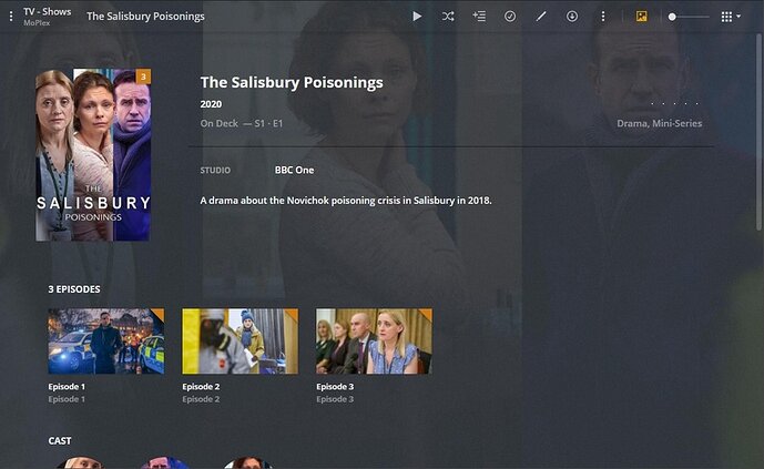

There’s nothing preventing the matching of this one that I can see - in this test:
A TV Show Library Folder\ <---TV Show Library 'Add Folders' aimed here - ONLY
....The Salisbury Poisonings\
........Season 01\
.............The Salisbury Poisonings - S01E01.mp4
.............The Salisbury Poisonings - S01E02.mp4
.............The Salisbury Poisonings - S01E03.mp4
'Cause that results instantly and naturally as:

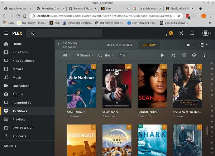

OK So i’m tearing my hair out over this issue. Ive done all the steps suggested by JuiceWSA including Plex compliant file naming convention, the “Plex Dance” and anything else I can find including downloading the files again. The originals were downsized using Handbrake to 720p 30fps instead of the BBC standard 720p 50fps to reduce space usage so I swapped the modified files with the original downloaded 50fps filed. I do this on all files downloaded using get_iplayer and never had issues before. I have made some progress in that I deleted the directory containing I May Destroy You and then added it back after emptying the trash and running the “Plex Dance”. It then appeared in the library for the first time, however I still cannot get The Salisbury Poisonings to display in the TV Show library see below assuming it should be next to Salamander?
Notice that The secrets she keeps has been identified by Plex and added! Here is the screenshot of my TV directory and the folder contents
I have tested the files in both VLC media Player on the Linux box where they were downloaded and also using Windows media player on the Windows 7 PMS Server and they play correctly. I have also checked the permissions on the files and they are Read Write for Everyone. I am therefore totally stumped what to do now.

Then, I’d take another look at Server/Agents and make sure LMA is enabled, but demoted for every tab under Shows and Movies - INCLUDING - TMDB in Shows:
(Note: Every Tab, Every Agent should look like that in Shows and Movies)
