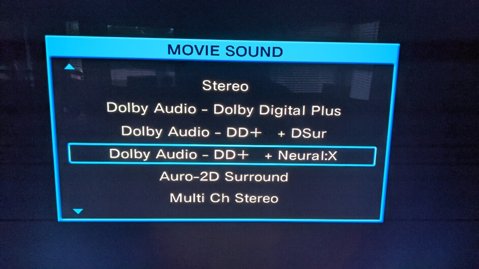

I also tried swapping the HDMI to my Xbox which does play Atmos when I tested in Games and a blu-ray, still no go. All I see are these options.
Any other ideas?

Just tried this and still not Atmos from Plex. I’ve tried a few different movies and always get the following. I’ve never seen DTS-HD come up either after checking a bunch of movies.
