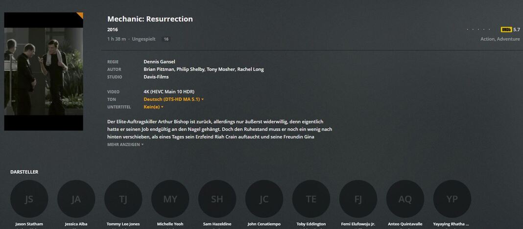

my NAS do not get the Posters from new added Movies, do you have any ideas why? I have the same PMS version on a Debian machine, an that works very well!
i tried to edit the “media agent” settings, but it didnt help. Its look like an 500 http error?!

in the meantime i once reinstalled the complete serversoftware and added the library again. Now it does not download any pictures at all. For all movies there is a “timeout” of the media agent.

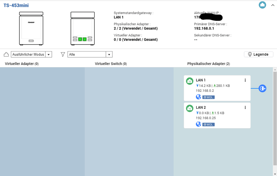

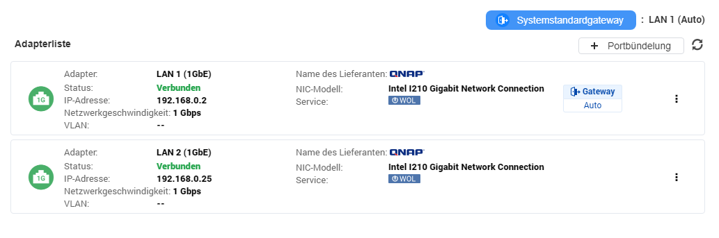

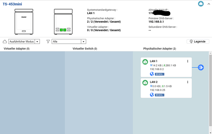

Can you show a screendump of Network and Virtual Switches on your QNAP?
sure. DNS is back on “auto” by the way.
Nailed it…
Unplug interface 2, reboot, and try again

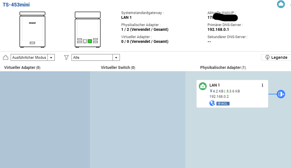

Unfortunately I had the same thought and have already tested it with only one. I just did it again and added the media library. It still shows me the same error messages.
The curl shell command works in this setup just like before.
for the sake of completeness, i have attached a log (with only one adapter) again. as far as i can tell it is exactly the same, is it?
