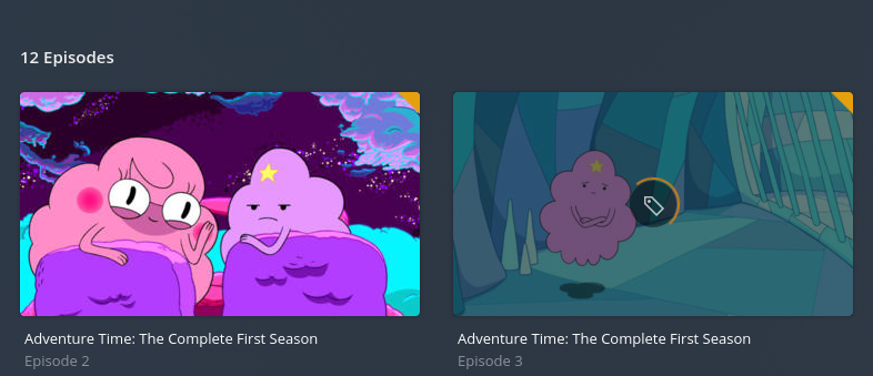

Ok so far ive had some success with getting the files detected.
as suggested by @FordGuy61 moved all the files out
“Empty Trash” > Rescan > rename folder with tvdb series id {152831} in the title
added back some files to test and noted that files renamed with s01e03.m4v as an example where being detected while others where not.
what’s strange here is that the names of each episode are not being added only a small preview of each show.
see screen shot.
so im about to play around with adding the tvdb id to a few titles and seeing if they are picked up with the correct title.
i think emptying the trash also helped with the rescan as nothing was being picked up before with the rescan so may have been some sort of XML corruption happening.
will report back after testing.

Ok we are gold now.
lots of troubleshooting and the final solution was to switch the TV library to IMDB which then pulled all the correct titles and cover art adding to all the episodes and Season artwork.

not sure if you can tell by the screen shot, this is the IMBD format with actors etc below.
as i’ve mentioned in my post once i selected to match with IMDB all the titles of each episode and actors populated also the correct artwork the the season as well at the primary cover.
