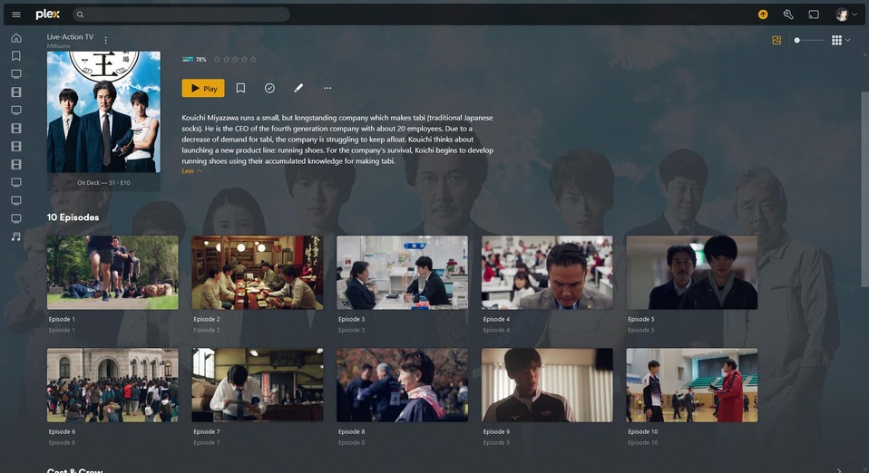

After removing the series, and doing a database optimize and cleaning bundles I added it back. The series info and poster reloaded but the episode thumbnails did not get downloaded initially:
So I waited for the intro/credits processing to finish, and then did a metadata refresh on the series despite it having just been added back 5 minutes earlier. The episode thumbnails now came back, but the episode and season synopsis are still not there:
Okay, I’d say the fact you are using tvdb episode ordering and there was no linkage between tmdb (default in plex) and the tvdb is most likely why its blank. Lets confirm in 48/72 hours once the edits I done yesterday to add these ids creep their way into the plex metadata back-end.
It worked. I did a refresh on metadata and the episode synopsis have now come in.
