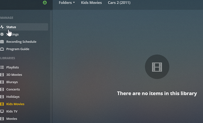

I keep a few separate libraries for the purpose of sharing with friends and family who have kids. So I keep a “full” library and a “kids” library that only contains kids movies. Simple enough, right?
I just added Cars 2 to both libraries. Same folder name “Cars 2 (2011)” and same file name “Cars 2 (2011) - (720RF22stereo).mp4”
Only the “full” library sees the movie and adds it to the library. The “Kids” library doesn’t add it. However, if I do a “Folder View” instead of title view, it sees the folder “Cars 2 (2011)” but says there is no media in the folder. But there is.
Any thoughts? Every other movie I have using this naming format “Title (Year) - (encode info).mp4” shows up just fine.

4 - Thought about that, but its not a matching error. The scan is flat out not seeing the file.
How can you tell?
Have you inspected the scanner log?
Have you checked file access permissions?

It does appear to be a permissions issue. For some reason there’s about 7 file folders that aren’t letting me access them through Putty. And those aren’t in my library either. How 'bout that?
Thanks!
No idea why the file / folder permissions would be weird, though. I always create them the same way, and it was fine in one folder. I’m new to linux, so this stuff baffles me.

Keep in mind that on regular Linux, Plex is executed under the user account plex and not under your user account.
https://forums.plex.tv/discussion/46104/new-to-linux-use-these-guides-how-to-set-permissions-how-to-add-ntfs-drives-on-linux#top
Yeah. I probably should just recreate my library folders. Lots of conflicts from when I was running Plex on my Synology vs running it on Ubuntu and just reading files off of the NAS.

Permissions issues between the NAS and the Linux server. Got it straightened out, though.
