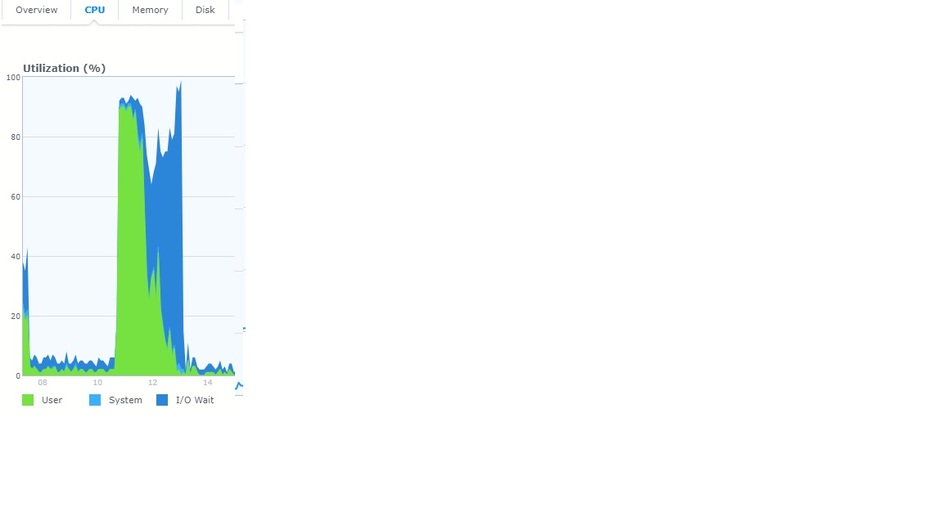

Here’s logs near a crash I suffered. and some perf showing my Disk IO slowly climbing, and CPU slowing dropping before the whole Plex and my Synology ground to a halt.
Plex Media (5.8 MB)
