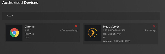

I run PMS on a WD PR4100…since I changed my password I cannot get it to run as a server. I have removed all authorised devices and if I connect to the server using the IP:32400 it doesn’t pop up as an authorised device as a server, it just shows it as the Edge browser.

Thanks for the response…so I have 2 media servers, one running on a Windows PC (Media-Server) and one on the WD PR4100 (Media-Server-2). The one on the windows PC shows up fine, I was able to claim it no problem after the password change.
On the WD it doesn’t even show up as a server in the “authorised device” list, when I try to connect on local LAN using (IP):32400 all that shows up on the authorised device list is the browser I am using to connect to the WD with
And on the left hand side all you can see is the Windows server PMS, not the WD one even though I am connecting directly to the WD device

If I open in incongito mode I get the web setup screens but will only show my the windows PMS and a mates PMS shared with me not on the same network…the PMS on the WD just doesn’t appear
