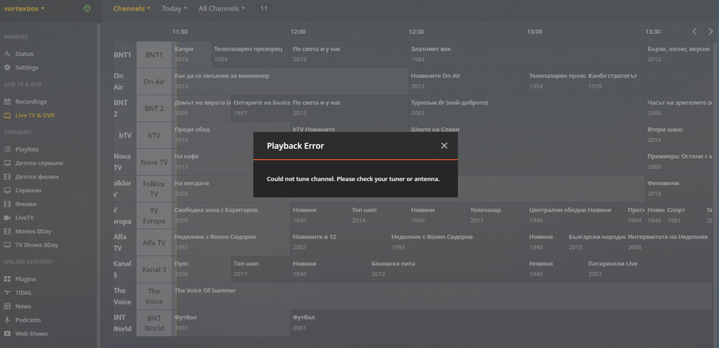

Playback error. Could not tune channel. Please check your tuner or antenna
Server Version#: 1.16.2.1321 and 1.16.3.1402
Player Version#: V3.99.2
Since updates stared after 1 of July playback of channels started to give following errors on most of channels:
Playing is working only on two channels without errors.
Plex Media Server Logs_2019-07-22_11-30-44.zip (804.3 KB)
Tried both versions of PMS available on PlexPass channel and free.
My tuner device is Hauppauge WinTV-soloHD. It is working perfect under it own application on windows 10 and before Gracenote EPG cancellation
Please help. Thanks.

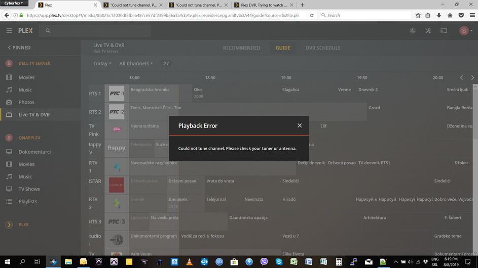

I have a differetnt issue. I have two machines running PMS One is a Qnap TVS-673e NAS and it is running tv shows Movies other Videos while the other is a old dell laptop (studio 1555) win 7 and it is used for live tv and dvr using haupppauge dual head. I had to use some generic EPG to be able to watch tv worked fine but only 5 channels matched but it worked fine exept 2 hd channel witch it didnt play most of the time but that is not the issue. Now i finally sorted the epg using webgrab all but 3 channels match but now it wont play any of the channels. I just get the Could not tune channel. Please check your tuner or antenna Error even though the tuner works fine with its own app (win tv) I restarted all the machines but still the same error. HELP PLEASE. Did anyone have a same issue? @support

I deleted and created the dvr more than 150 times in the last week alone. I tried everything i could think of. I grabbed only one day only a few channels two days etc .The best i was able to do was to get only two channels to work out of 28 i enabled. Strange. The biggest question i have is why not enable live tv to play without epg? I made the dvr for my mom who is old and lives in Germany so that she could watch our TV since the landlord doesn’t allow a satellite dish. As it stands now she is put-off using plex for tv since the names are all wrong, not the epg data since she doesn’t really use plex well more of a point and click. And why cant plex grab epg using ota? I hear that a lot of country have not a good OTA epg but in Serbia the OTA EPG is great. This is a mystery for me since all the channels are known and published on https://www.dvbtmap.eu and all the data they need is availabe, tat least the could have listed my country … I am at a loss I have spent all this time to get webgrab to work and finallly all the channel names are correct but at best only two work

I paid someone to take care of my epg issue and we figured out that channel id and name has to be one word and no spaces than everything works. that is a plex bug…stupid oversite. Still cant play hd channels thats also a plex issue but all works fine and epg is correct. You should try to use wrong epg to see if the channels work at all.
I used this epg for a month the names and guide were wrong but all channels played.
http://tvprofil.net/xmltv/data/epg_tvprofil.net.xml
just try it if they all work than that is the issue and modify the config to have the channel name and display name only one word without spaces and all should work
Yes, I use webgrab++ tool to mage my own EPG. I tried your suggestion and yes, now all channels are playing without errors. Many many thanks for your advise. That fix the issue.
