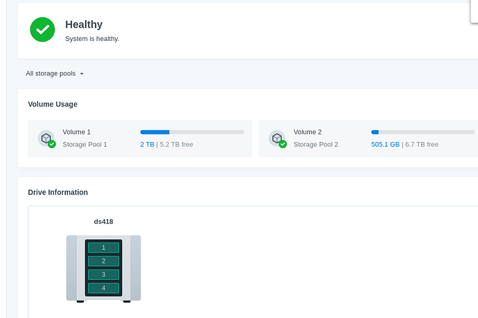

can you tell me how full each volume currently is and how big each drive is?
(I’ll do the math here and then show you a way to move things around.)
Currently this is the status of my Hardisks
Drive 1: Used:3.44GB Free:3.48TB Capacity: 3.5TB
Drive 2: Used: 3.3TB Free:286.89GB Capacity: 3.58TB (Almost Full)
Drive 3: Used:773.18GB Free:2.82TB Capacity:3.58TB
Drive 4: Used:395.27GB Free:3.58TB Capacity:3.58TB

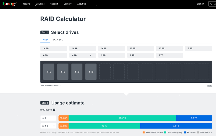

Letting the Synology RAID calculator do the math (it’s a good tool)
4 drives, 4TB each, SHR-1 (1 drive failure protection), you get 10.9 TB usable when all 4 are in the RAID volume.

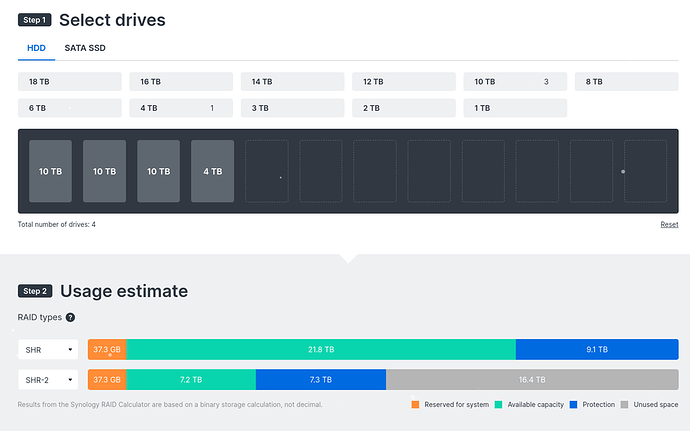

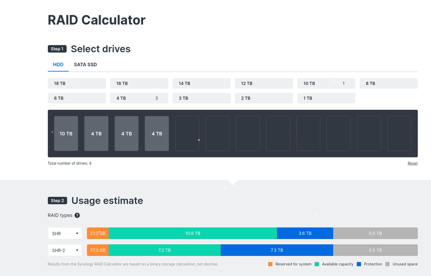

Here is an example: 3x 4TB with 1x 10TB
Here’s how it is with 2x 4TB and 2x 10TB (16 TB usable)
Then, one by one, as you finally work your way to having all four drives at that larger capacity, you end up with no unused space
Play with the calculator. It recalculates automatically as you change configurations.
