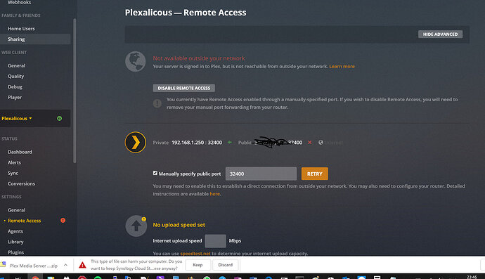

Okay, so I’ve noticed the same behaviour again. Attached the most recent logs. I think I checked if PMS was reachable at around 22:45. It’s now 23:26. When I got to Settings => Remote Access I get the infamous red exclamation mark. I was watching some content while on the same network.

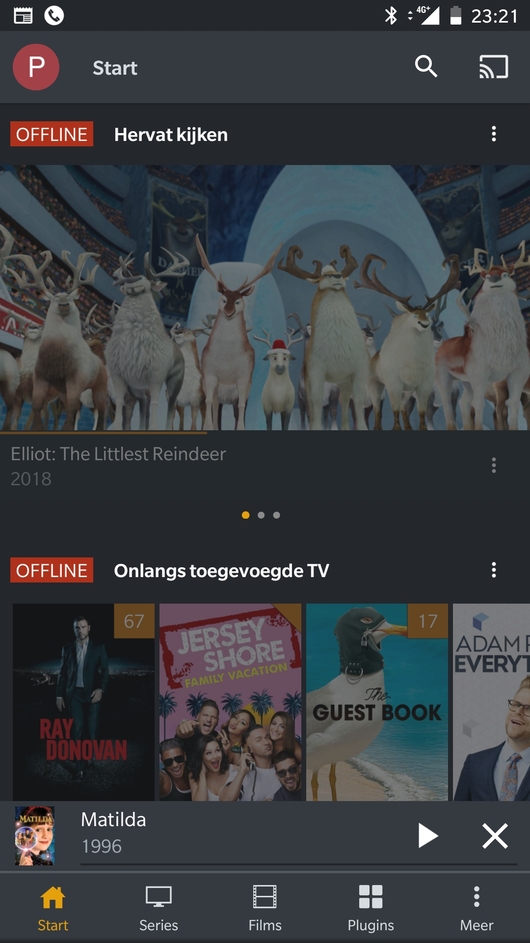

Noticed the issue @ ~23:15. At around 23:22 I re-enabled remote access by pressing ‘retry’ in Settings => Remote Access. It’s still set to 32400, port forwarded.
Before I re-enabled I noticed some strange behaviour while testing from outside. I used my Android phone on 4G => when opening the app I noticed nothing was accessible. I tried starting something but this obviously did not work. But now the strange part => I opened my mobile browser, went to plex.tv/web and low and behold - my PMS is reachable from there. Could even start content. While still having the exclamation mark mind you. Weird. Tried the app again, and nothing. Even after re-enabling the remote access I had to force close the app and start it again to get it working.
Notice I have Tautulli running again because leaving it off did not seem to do anything for me. I’m not getting any notifications about not being reachable from the outside from my agent btw, even though notifications are working (tested).
