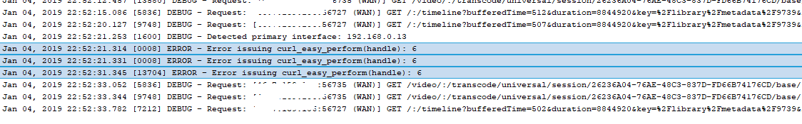

i can’t see that in the log - well, not happening after you look at the bandwidth chart
Looking at the 2nd zip file - for 3rd and 4th January, I can see that bandwidth statistics were requested from the server at 22:53:25 on 4th Jan.
But there network issues before that - with the network interface going down a number of times and at times when no bandwidth dashboard staticstics were being requested
The network interface on the PC went down at these times
  • 3rd january after 21:44:15 and recovered 09:23 am on 4th January - with momentarily coming back between 02:00 am and 02:04 am
Throughout this period DNS was down and so all attempts to communicate with plex.tv were failing - see curl error 6
I will have a look at the other set of logs - but at this moment there is no evidence that it was related to the bandwidth dashboard view.
I have looked at the logs from the 30th December. The dashboard bandwidth data was being requested between 21:24 and 23:40 on the 30th. After this you disablled and re-enabled remote access at 23:41. A connectivity test immediately before this at 23:40:55 was actually successful and reached the server - it was at that time through uPnP public port 15632 - so there was no reason to disable and re-enable remote access. I see you switched to manually specified port 32400 at this point - it was not before that
What made you think remote access was down ? The oldest log entry was for 21:21 pm on 30th. You were already watching the bandwidth chart - so if something went wrong as you started - it was before the beginning of the oldest log file. You have verbose logging enabled - suggest you switch it off and instead ensure debug logging is enabled - verbose server logging is only needed for specific investigations. With debug only, hopefully the logs would cover the time when remote access apparently drops off
If you could try again without verbose logging and with debug logging and when you think it dropped off, try with a mobile device with wifi disabled

I need to see the logs when Plex Media Server made a connection to the Pubsub server = this is a machine that get used for connectivity testing and raising events to Plex Media Server. I can see that the server failed to get an event for the connecitivity tests at 10:47 on january 6. Also at 12:23 and 12:25
I see that you are running Plex Media Server as a service or scheduled task. Of course there would be a risk of it running another process outside the service - This can arise if you use a different windows account for install - different from the account the service runs under
I need to establish which pubsub server the Plex Media Server is using for the events. Unfortunately the period of time covered by the logs does not show any connections to pubsub servers. You have verbose logging enabled and that fills up logs very quickly. For this type of issue, debug logging is all that is needed - see https://support.plex.tv/articles/201643703-reporting-issues-with-plex-media-server/
May be there was an issue establishing the connection to the pubsub server - you mentioned firewall off. Is there anything that may be blocking the connections to these servers = the pubsub servers ?
So could you disable verbose logging in server general settings and ensure debug logging is enabled. Restart the server, wait 10 minutes and then capture the logs. Confirm that remote access works. Then when you have the problem, confirm it is down by attempting access through a mobile device with wifii disabled. Note down the time so you can mention it here and capture the server logs and screenshots of the remote access setting page. and attach here
Then go through disable / re-enable remote access. and if there is an issue,. refresh the browser with F5 and again capture logs and screenshots

Thanks for providing the logs.
The logs you are using the default automatic configuration of remote access through a dynamically allocated uPnP port.
Each attempt to get the router map a port is failing
Jan 05, 2019 16:23:27.337 [13248] DEBUG - NAT: UPnP, attempting port mapping.
Jan 05, 2019 16:23:27.399 [13248] WARN - NAT: UPnP, error mapping port 17133, error: Action Failed, controlURL: http://192.168.1.223:5555/ctl/IPConn.
Jan 05, 2019 16:25:06.128 [11956] DEBUG - NAT: UPnP, attempting port mapping.
Jan 05, 2019 16:25:06.183 [11956] WARN - NAT: UPnP, error mapping port 28811, error: Action Failed, controlURL: http://192.168.1.223:5555/ctl/IPConn.
Jan 05, 2019 16:25:09.933 [1328] DEBUG - NAT: UPnP, attempting port mapping.
Jan 05, 2019 16:25:10.018 [1328] WARN - NAT: UPnP, error mapping port 24969, error: Action Failed, controlURL: http://192.168.1.223:5555/ctl/IPConn.
Jan 05, 2019 16:26:52.937 [0876] DEBUG - NAT: UPnP, attempting port mapping.
Jan 05, 2019 16:26:52.997 [0876] WARN - NAT: UPnP, error mapping port 18830, error: Action Failed, controlURL: http://192.168.1.223:5555/ctl/IPConn.
Jan 05, 2019 16:27:15.128 [11968] DEBUG - NAT: UPnP, attempting port mapping.
Jan 05, 2019 16:27:15.193 [11968] WARN - NAT: UPnP, error mapping port 17417, error: Action Failed, controlURL: http://192.168.1.223:5555/ctl/IPConn.
Jan 06, 2019 15:36:15.575 [18224] DEBUG - NAT: UPnP, attempting port mapping.
Jan 06, 2019 15:36:15.575 [18224] DEBUG - NAT: UPnP, didn't find usable IGD.
Jan 06, 2019 15:36:15.575 [18224] DEBUG - PublicAddressManager: Mapping failed.
Check that NAT / uPnP are enabled in the router
It may be that the router got into a state where it needs to be rebooted
If problem persists and disabling / re-enabling remote access does not succeed in getting a port mapped, get some wireshark packet capture to go with the logs. Download wireshark link Wireshark · Download
Save the wireshark capture to default pcap file and zip and send me by private message and provide logs as before
If automatic port mapping continues to fail, consider switching to having a port forward setup in the router and selecting manually specify port
