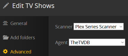

What is set in the properties of your tv show library as ‘Scanner’ and ‘Agent’?#
Agent is TVDB, where do I find scanner?

Right above Agent in the Advanced settings for the Library.
Screenshot_2021-01-07 Plex(2)
Uhm, no?

I updated my server to the latest experimental version, and now I do see the scanner under settings.

Which scanner are you using?

@Dan_Bev as far as I know the tvdb. and on a test machine I upgraded to the latest version so that one uses the new plex scanner with the tvdb agent. same issue there with matching and wrong special naming.
