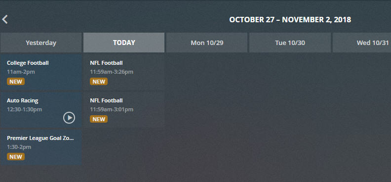

I have been recording on DVR for the past few months with multiple cases in which a show is not recorded. Looking for help to understand how to read the data logs to understand what my be going on.
For example, yesterday I tried to record a college football game. DVR created a folder for the recording like it does for every TV show it records, but did not create the file. No warning on the web server on why it did not record. Sometimes I get a “Transcoding Error” on files that don’t record correctly, this one had no error. There is no “play” symbol either after the College Football 11am-2pm file name on the webplayer indicating this is no file to play. In this case, no file was created at all. Other times, a partial file would be created but it stopped recording for some reason. I figured I would start with one issue at a time.
Plex Media Server Logs_2018-10-27_17-20-14 No Football College Game Recorded.zip (4.2 MB)

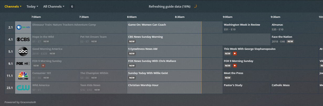

Here is another case in which a show did not record correctly. In this case, it was FOX 9 Morning Sunday. in which is was scheduled to record at 9am. Unlike other shows, this does not list an Season and Episode number but rather is just lists today’s date. This was not part of a series, I just selected it to record this hour. After I saved the recording selection, under the Recordings Calendar View, it did not list this 9 am show to record. Instead it had a yellow exclamation mark icon next to it along with the time slot of 7-8 am, instead of the selected 9-10 am. Looking back at the schedule, there was indeed a 7-8 am show with the same title and for some reason it also had the recording icon listed at the 7 am time slot, even though that hour passed. I was curious if the show would actually record the 9 am start time so after a few minutes, I checked and Plex did create a folder under the .grab folder but there was not file listed as being recorded. I than looked again 10 minute later, and then a file was present and recording. After the show was completed, it showed that the show length of 50 mins when it should have been 60 mins (did not remove commercials). So i have attached the data logs again to see if anyone can tell me why this did not start at 9 am but rather 10 minute late.

I had this problem and I thought the update had fixed it but it hadn’t. I looked into it more and realized all the the channels were vhf broadcasts can and I attributed the problems to signal quality. I changed the the orientation of my antenna and I have great signal quality and have had no problems for almost a week. Are you using an antenna? It looks like all your failures on on fox.
Edit all markets with Fox 9 transmit in VHF. Double check your signal strength. You may have to use a 3rd party program. The signal strength displayed in Plex is the strength at the time the tuner was added and not updated with real-time signal information.
