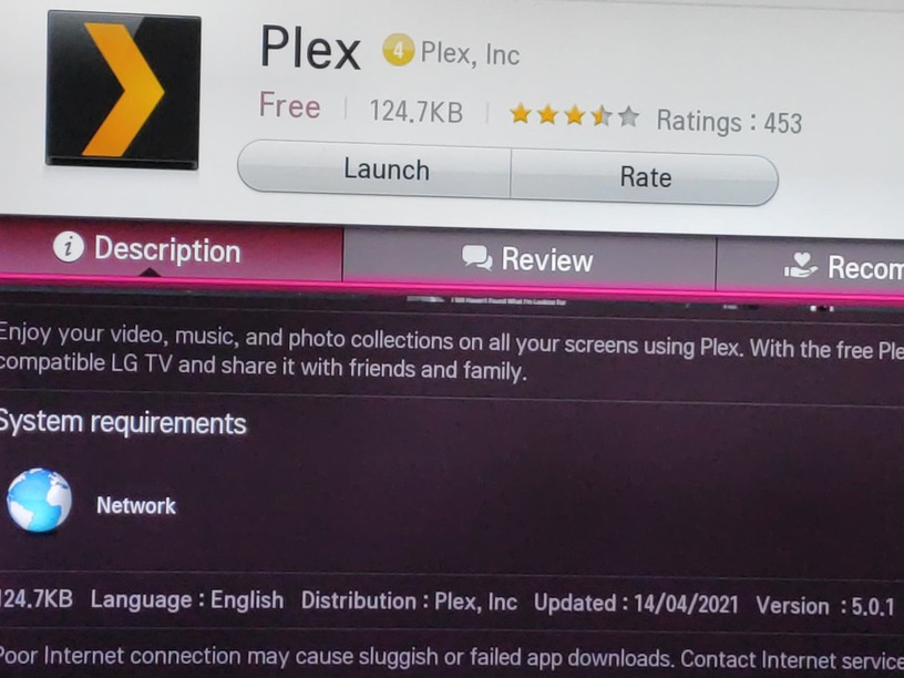

Server Version#: 1.25.1.5286
Player Version#: 5.01
App version appears to be 5.0.1
In settings->about it says
Plex for LG - 3.13.29
Netcast - 0
Plex for LG app appears to no longer be able to sign in to Plex., Last successful use was Wednesday 7th at 22.36 CET.
Everything works fine on all other devices.
I’ve tried insecure connections etc, the issues doesn’t seem to be conecting to server, but to Plex. Changing settings does not save them. It is not possible to sign in.
