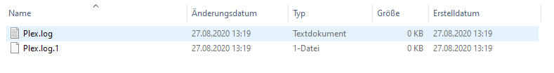

Sounds similar to another reported case - could you do a list directory of the logs directory showing the file size and date / time created And also get a process dump of the hung process after launch
This are the files created in %LOCALAPPDATA%/Plex/Logs
