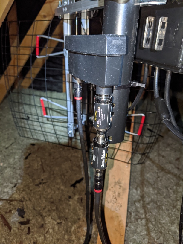

Very few of my stations show a signal strength of 100, and ION 33.1 isn’t one of them, as the first post in that thread shows. My main issue is the new LTE band 71 interference from the auctioned off 600 MHz spectrum. I now have a T-Mobile tower a few blocks away blasting away on band 71.

That filter is useless, as it doesn’t cover 600 MHz, or even 700 MHz. I’m using TWO of these with excellent results:

Similar to my setup in the attic

The filters seem to be taking care of the band 71 issue.
