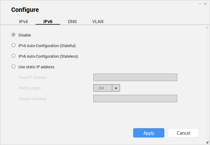

Please disable IP V6, then reboot your QNAP

I disabled IP v6. I rebooted the QNAP. No changes.

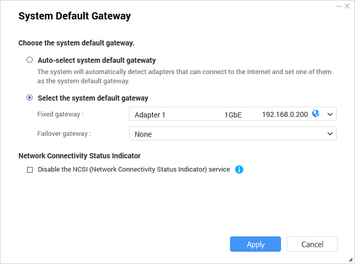

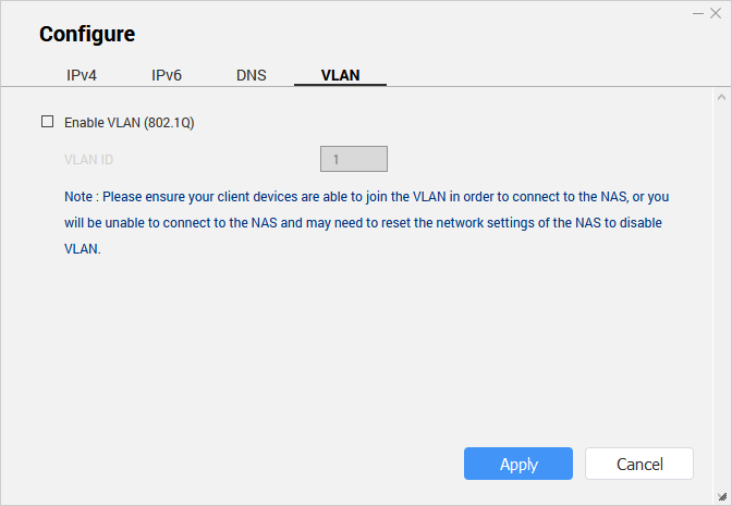

For sanity sake, let’s get another set of screenshots of your Network & Virtual Switch now that you’ve rolled back to 4.3.6.
It was not normal to see two screenshots from a running system where one lists your default gateway as ā€œNoneā€ while the other lists your first NIC. That’s why I’d like you to check your QNAP network setup. Inspect to see if it’s dropping its default gateway repeatedly.
I’m going to continue to suggest on the QNAP you start using a static IP, manually set the default gateway, and manual port forwarding on the router. Does anyone see a downside to that?

I performed a shutdown this morning, and I started the QNAP a few minutes ago.
Here are the screenshots:
From the logs, you might see that after the reboot I wasn’t able to reach PMS failed. But shortly after, I tried again and it worked. But not for long, because afterwards, it failed again.
