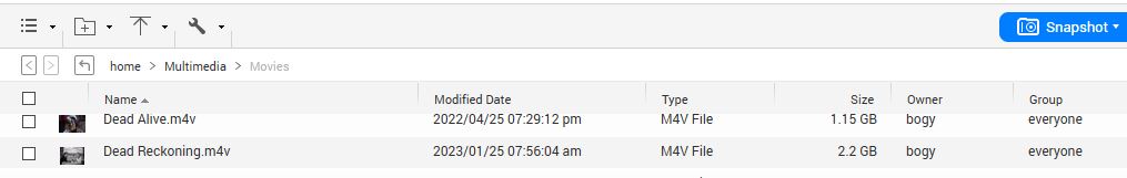

Please show us a screen capture from like file station, showing us the naming from the root of your library all the way down to the .m4v file
Picture attached.

Since you are not following the naming standard, it’s most likely matched as something else
I not only recommend a separate directory for each movie, but also that you follow the standard
Ref: https://support.plex.tv/articles/naming-and-organizing-your-movie-media-files/
As such, naming should be:
Dead Reckoning (1947) {tmdb-20663}/Dead Reckoning (1947) {tmdb-20663}.m4v
Also, you have your medias in the QNAP share named Multimedia
That is also not recommended
Ref: Qnap faq.....read me first!

Followed your instructions and Plex now see’s the movie.
Thanks for your help!!!

And looking again at your Screen Capture, I stand corrected regarding the Multimedia share, since not the QNAP one, but instead one you created in your Home directory :wink:
