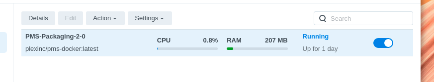

I have gone through about 30 uninstalls/installs on my DS918+ with DSM 7 and seem to have PMS working however I cannot add my library of media from my NAS. It seems to recognize that the folder is there but does not scan anything.
What am I missing/not doing? anybody know?
@Tombadog

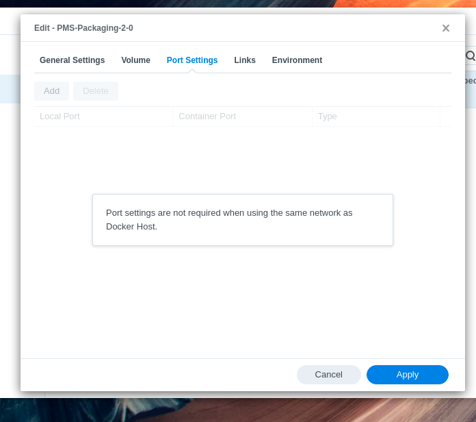

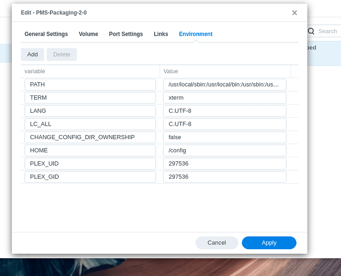

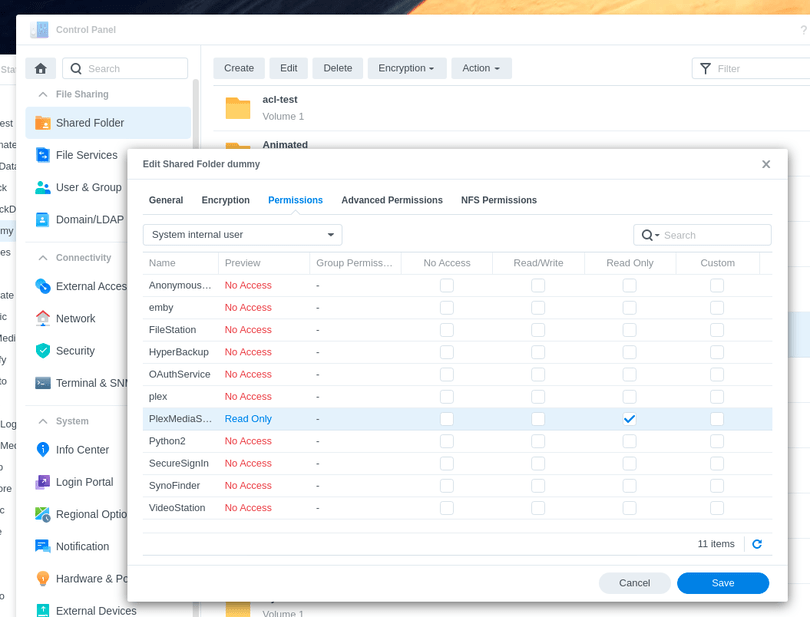

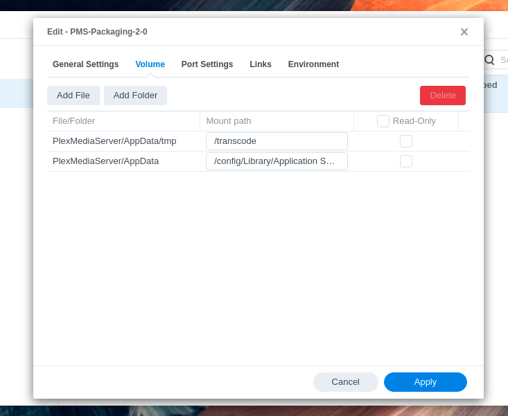

When you map the folders as I show in the How-To , and use the UID/GID for your system, in HOST network mode (not bridge), it does work.
You must have the permissions set correctly in DSM before creating the container else it’s a moot exercise.

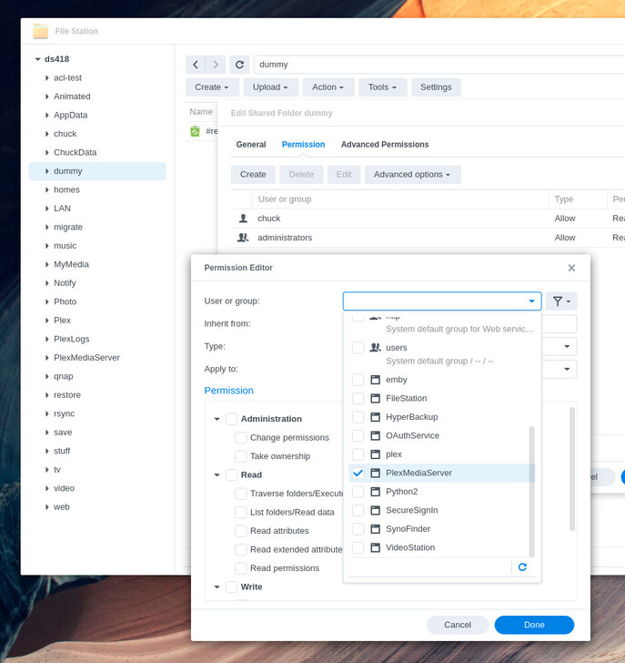

@wcarter
Did you go to each of your shared folders and give System Internal User PlexMediaServer permission to read them?
This is a manually required step (Plex has no privileges unless you grant them) on Synology NAS systems.
