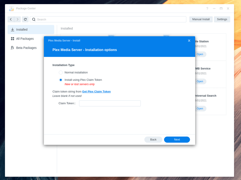

There is no claim server option

@RBH4908
Installation Type

@RBH4908
show me what you’re seeing?
I think you’re getting ā€œUpgradeā€.
The menu options are hard coded . It is always present for ā€œInstallā€
