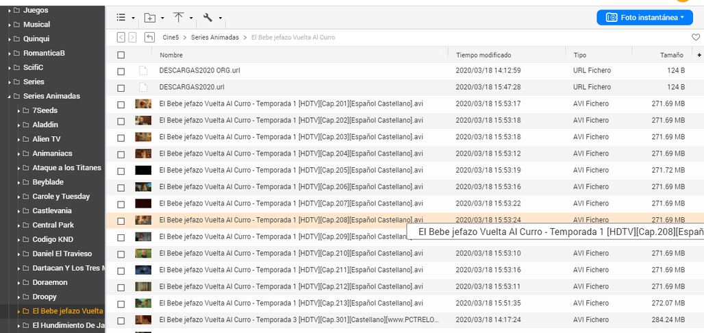

  • What path is defined for the library ?
  • What agent is used ?
  • Show screen dump of file structure, from root of library all the way down to the actual media
  • I see no traces of a season folder?
Ref: https://support.plex.tv/articles/naming-and-organizing-your-tv-show-files/

As can you see, plex only see 13 episodes when in the same path has many more. Before saw everyone
And as I see it, you are NOT following the naming standard, as I linked towards!
You have a library root path defined as /share/CACHEDEV3_DATA/Cine5/Series Animadas
So below that, you should have a directory named The Boss Baby Back in Business (2017)
Below that again, you should have a directory named Season 01
And in that directory, the media files for season 01, like:
Scooter Buskie -S01E01- .avi
Super Cool Big Kids Inc. -S02E02- .avi
Notice in above the Season 01 folder, as well as the individual episodes has SxxEyy in their naming!
Edit: And adding, that your files has something like [Cap 208] in it, and assume that means S02E08 ?
Also note, that text in square brackets [] is ignored by the scanners and agents!
