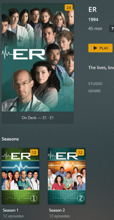

This is the first time I’ve had a problem like this since I started using Plex about 3 years ago. I have my TV shows in Plex\TV\ER\Season x and their names are like ER - 1x01 -
episode.mkv.
I’ll copy newly ripped and encoded (using Handbrake H.264 - same template I’ve used for many months with no problems) into my directory and sometimes they show up, most of the time they don’t. I completely moved the ER folder out of Plex and started copying them back one by one or season by season. Now, it will only show the first 9 episodes of whatever season I move in there. I’ve very strange. I’ve edited the file metadata hoping that was the issue, but didn’t change anything. I’ve made sure the permissions were similar to all other files that work… no difference. I’m at a loss as I’ve added hundreds of TV shows with this exact same methodology in the last few months and only now am I having an issue.
Update - I copied episode 10 of ER season 8 by itself into Season 8 directory and it showed right up so I copied the rest of the season in there and it will only show 9 episodes 1-8 & 10.
Any suggestions?

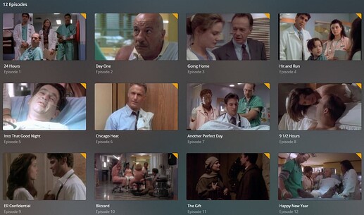

Edit the season. Do you see all the files listed?
Maybe Plex thinks some of the episodes are duplicates. I created a duplicate for s01e12. Now has the option for Play Version, which does not appear if there is no duplicate.
The real fix is to rename according to Plex recommendations, as shown in first post. If you want to test, remove the entire show from the library, rename one season, then put it back into the library. If it works, rename the other episodes.
Screenshot (781)
Screenshot (784)
When I go into info for the whole season, it will only list 10 episodes. I renamed them to the sxxexx version and there was no difference.

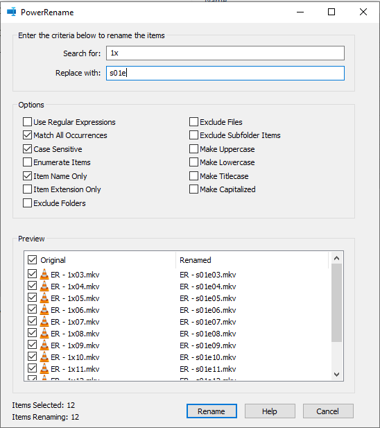

As @Insomnic_1 mentions, there are tools to help with renaming.
Many people use FileBot. It has Plex templates and can rename your entire library quite quickly.
For Windows, there is PowerRename, part of PowerToys. While not nearly as powerful as FileBot, it can be used to easily rename all the files in a given folder.
