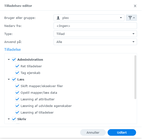

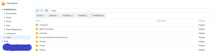

I took backup of some of the hidden folders as well as the PlexMediaServer folder to keep my Plex information. After looking through the many posts with DSM 7 and Synology I got the Plex up and running. My problem now is even when giving the Plex user Full control of my newly created shared folder called video or music, I cannot select any of the subfolders when adding folders to libraries. As you can see in the uploaded picture the video folder appears empty.
Looking at the Permission inspector the Plex user does have rights to all the subfolders but still cannot see them when I try to add folders. What am I missing since this doesn’t seem to work right now.

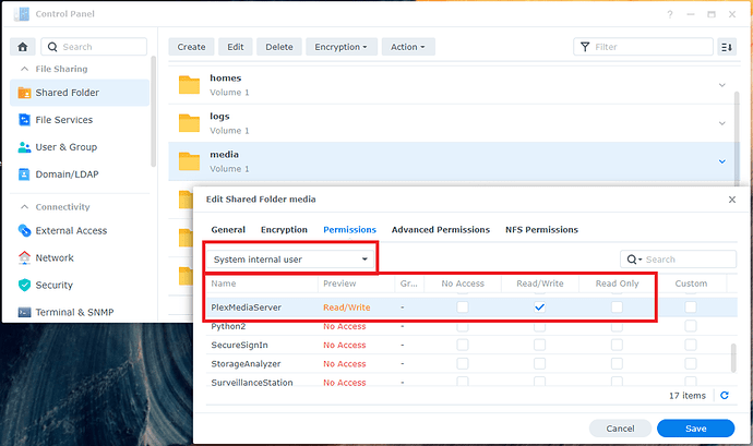

PlexMediaServer is a System Internal User. It is not visible in Control Panel → User & Group like standard user accounts.
If you have Plex Media Server installed on your system, you should see a PlexMediaServer user.
Please follow these steps and report back whether or not you see the PlexMediaServer user.
  1. In DSM, go to Control PanelShared Folder.
  2. Select the shared folder where your media is located.
  3. Choose Edit → Permissions.
  4. Change Local Users to System Internal User.
  5. Do you see a user named PlexMediaServer?
No: Something went wrong with the installation of Plex on your DS720+. Stop & report back.
Yes: We can proceed with setting folder & file permissions. As long as your on that panel, select R/W or RO permissions for user PlexMediaServer & Save.
If you’re using optimized versions, LiveTV & DVR, etc, choose R/W, as Plex needs permissions to write to the folder.
