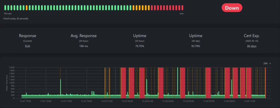

I’ve also moved monitoring from Tautulli to Uptime Kuma to get better stats.
It checks every 20 seconds if the server is up or down.
Since the problem started the uptime dropped to 76% already (but half of the period was without the issue), I’m shocked that this issue is not getting worked on by the devs.
