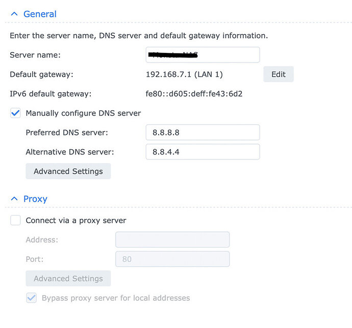

My Clock is set correctly but unable to update. it seems I’m also unable to connect to package center but I seem to have the correct DNS settings of 8.8.8.8 and 8.8.4.4
Also if it helps here are my network settings

Definitely having DNS issues… which will occur if the network itself has a problem.
May 12, 2022 20:02:24.019 [0x7feb3ec44b38] INFO - [CERT/OCSP] couldn't fetch a valid response; retrying in 300 seconds
May 12, 2022 20:02:24.037 [0x7feb3edc1b38] WARN - [HttpClient] HTTP error requesting GET https://plex.tv/media/providers?X-Plex-Token=xxxxxxxxxxxxxxxxxxxx (6, Couldn't resolve host name) (Could not resolve host: plex.tv)
Your DNS settings are correct. The Syno is having difficulty getting to the internet.
Not sure if this helps, but I noticed I have a static IP for LAN 1
Those tell me what your LAN IPv4 and IPv6 addresses are.
If you don’t use IPv6 on your home LAN (most of us don’t yet), you can turn IPv6 off.
What happens if you take ANY synology package you don’t have installed and try to install it ? (you can uninstall it as soon as we confirm connectivity)
If it can’t install – then it’s between the Syno → switch → router
What’s the default gateway IP ?
