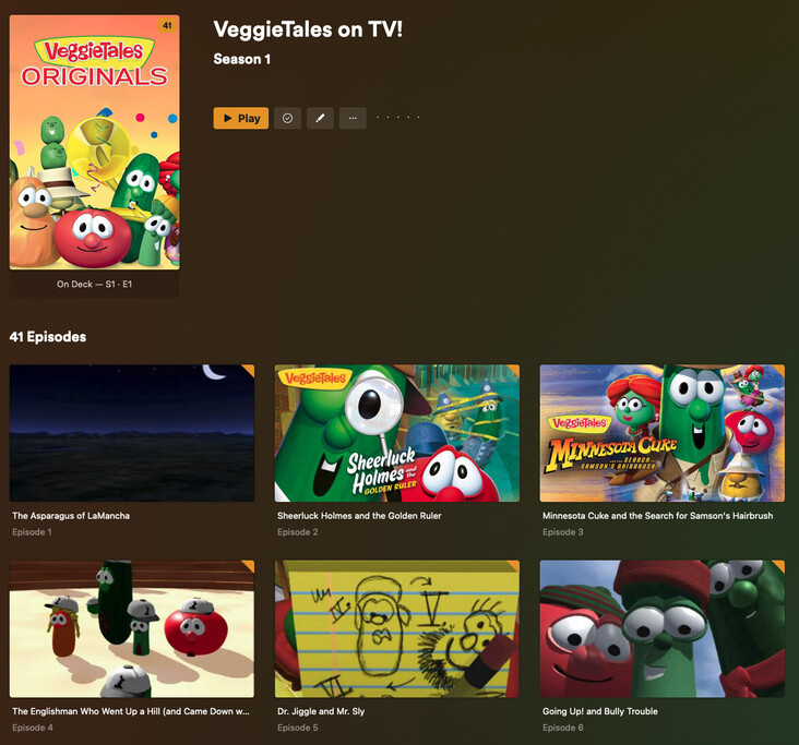

Default Library Episode Order:
TVDB (Aired) Episode Order:
The TVDB episode order is 100% wrong. lol (Also yes, I tried with and without refreshing the metadata after choosing the new episode order.) Compare this screenshot to what is actually listed on the TVDB series episode list: https://thetvdb.com/series/veggietales/seasons/official/1

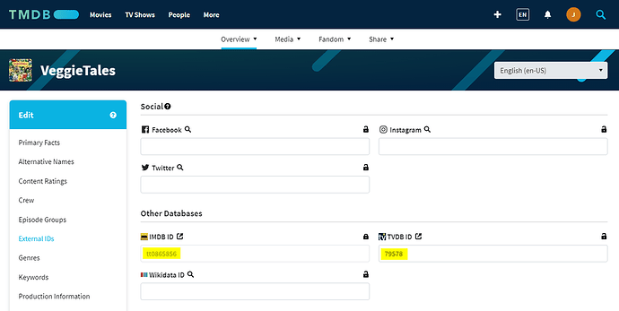

There’s two different shows listed on TVDB.
The Plex database (plex://show/5d9c08772df347001e3b3db0) is confused and combined both into one show.
<Guid id="imdb://tt0865856"/>    <-- VeggieTales (TMDB is linked to this one)
<Guid id="tmdb://5024"/>         <-- VeggieTales
<Guid id="tvdb://394604"/>       <-- VeggieTales on TV (This one needs to be split out in the Plex database)
<Guid id="tvdb://79578"/>        <-- VeggieTales (TMDB is linked to this one)
So is there a way to fix it? :pray:

Any idea how many hours it would take for the changes to propagate in the database? I’ve retested everything but nothing has changed (with the exception of the show title coming from the Plex TV Series agent – which now says “VeggieTales”).
To be clear, setting episode sort order to “TVDB (Aired)” is still showing the horribly broken metadata rather than what’s expected.
