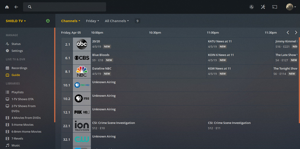

I have a Shield TV Pro running Plex Media Server and I cannot keep the EPG updated with accurate information. Right now, if I check guide listings 24 hours out I get many “Unknown Airings” listed for multiple channels:

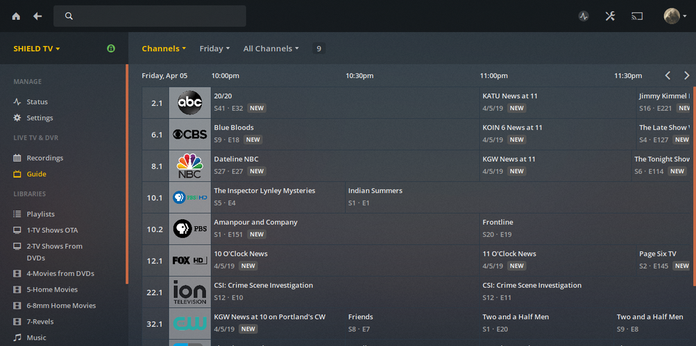

If I run a manual EPG update I then get the correct data:

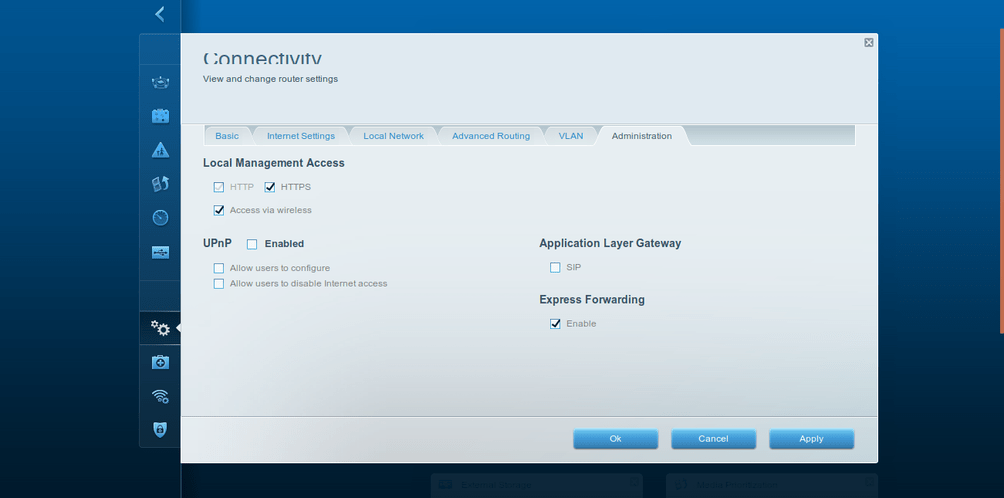

How badly do you need UPNP active on your Router? Plex is receiving invalid responses to it’s UPNP requests. There are also some messages where it thinks it has lost internet connectivity so it can’t finish guide data requests.
The pickle you are in is that 1.14.x was known to have guide refresh issues but going to 1.15.x may bring new ones.
I don’t have UPNP active on my router.
Not sure why it would lose internet connectivity with any frequency. Have been having some issues with intermittent drops from my ISP but I wouldn’t think they would occur every night at the same time.
Took another look at the logs with a different text editor, probably a red herring on the UPNP.

Just checked EPG again. Only have data to about 12:30 am tomorrow.
Update: I just checked the EPG and all is normal through Friday at least. This is several hours after a MANUAL update but before the nightly SCHEDULED update. Something seems to be wrong with the auto update run at 2am as a scheduled task.
Given up on the EPG and Plex Support ever doing anything about the problem. I’m now running ZAP2XML on an Ubuntu system to create an XMLTV file for the Shield. This is definitely NOT how I want to run PMS as it should be a standalone system, but this is the only way I’ve found to keep the EPG updated correctly.
