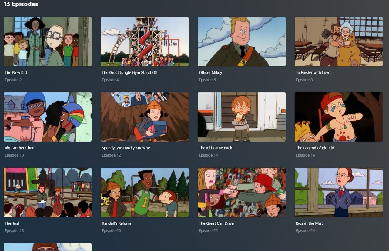

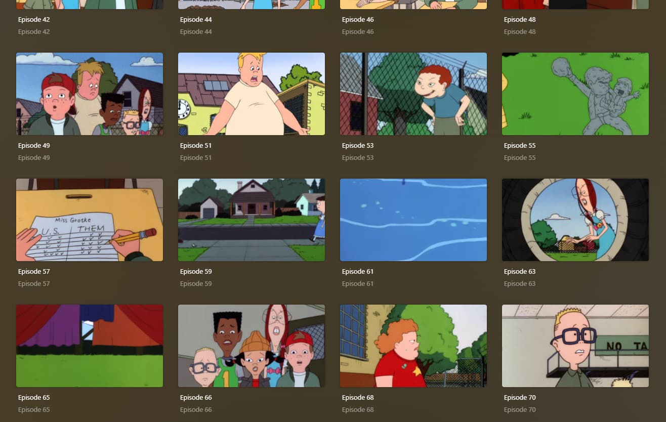

Not sure if this is a bug or not, however, it appears to have occurred on both of my Plex servers. I added a show that has 2 episodes per file. Normally these dual episode files would be recognized based on the required naming format that Plex uses. However, it appears to be ignoring the naming format and only recognizing the trailing episode number. Did something get broken in the most recent update? This was working properly prior to the latest update.

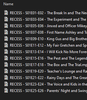

Naming format for each episode is: ShowName - S01E01E02 - Episode Title.ext
However Plex is only recognizing the file as episode 2 only and not even displaying episode 1 on the Plex web interface. I tried refreshing, analyzing, doing the Plex dance (removing, empty trash, clean bundles, and re-adding) and it does the same again for all 3 seasons with only showing every other episode.

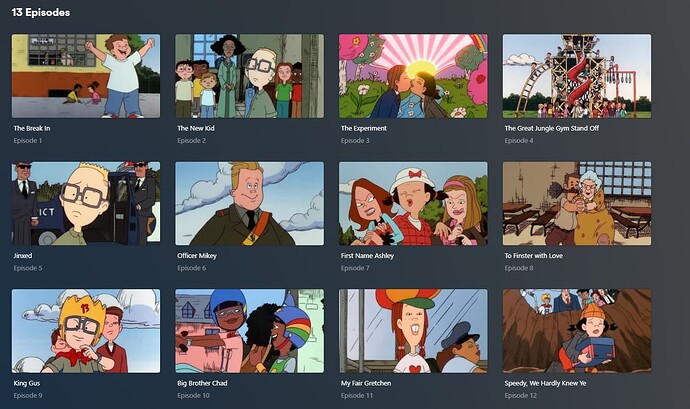

Episode 1 for both season 1 and 2 show up and work fine.

This is how the files appears in the file system:

Can confirm this just started happening to me too. I scanned my library to find only every other episode appeared. To check, I tried re-adding another show that displayed normally before. I have multiple shows with several episodes per file, all named with S02E17-E18 notation. Copying them exactly as they are to a new TV Shows library causes this effect, even though they’ve been correct in my main library for years after adding them originally.

Found a PARTIAL fix. And then I found a WEIRD occurrence.
I renamed the First/Second file to: RECESS.S01E01-E02.The.Break.In.and.The.New.Kid.mp4
(Note all the periods placed all the way through the file)

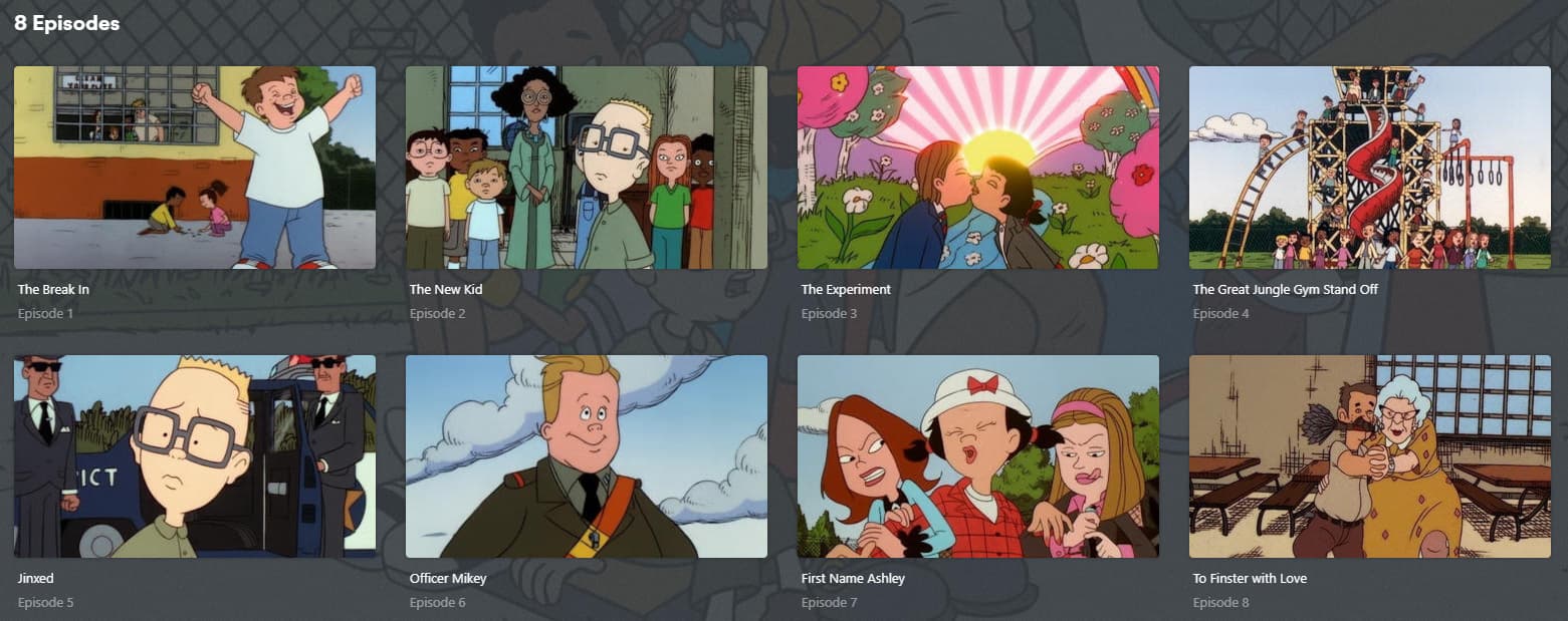

This resulted in BOTH separate servers showing episodes 2 to 26 now being detected and showing in Plex. Episode 1 was not being found (and this was the episode file I changed)
How this effects ALL episodes when only renaming the FIRST episode I have no clue.
So I then renamed ALL files in Season 1 to use the above format with periods. (It takes 5 to 10 minutes for the scan and intro/credit detections to run each time I rename a file).
And it now shows only 15 episodes but it included Episode 1 and Episode 25 but not the rest of the ODD number episodes.
Don’t know WHY this is happening all of a sudden. But it does point back to something changed in the server. Why would it suddenly change how it detects episodes based on whether the file name has periods between each word or between the title and the Season/Episode numbers or not? And why would it remove the ODD episodes from 3 to 23 when I change the rest of the file names to match the first file name?!?

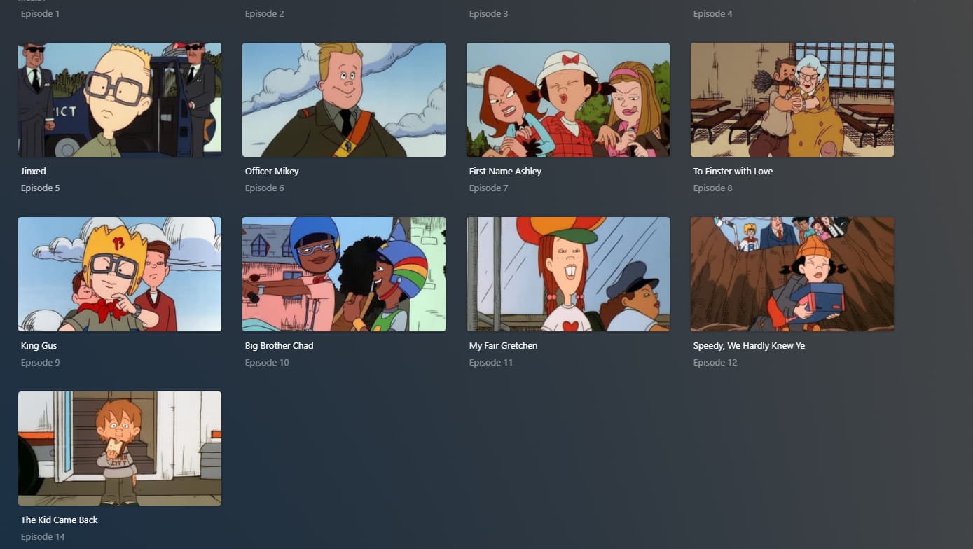

I also found that when Plex got to any single episode files, it switched from Even number episodes and then when another single episode hit, it switched back to odd episodes. This is definitely something to do with the server and how it’s seeing the files.
See below:
We see Plex flip flopping between Even episodes and Odd episodes and back when it hits a single episode file.
And it’s skipping Episode 1 no matter how the files are named for all 3 seasons.

I did some more testing.
I had episodes E01 to E12 added to the folder and all 12 episodes showing in Plex.
Adding a 7th file to S01 folder (E13E14). Only episode E14 displays. E13 shows as missing. And plex shows 13 episodes at the top of the list.
I then make a small change to the file name for E01-E02. Plex scans and 13 now displays, but 1 disappears. 2 still shows.
I make a small change to the file name for E03-E04 and now once Plex scans the show again, E01 re-appears in Plex but E03 disappears. Most likely because it was the last file updated in the database for that season so that file doesn’t get the multi-episode addition within the database.
It does appear to be a limitation or a max number of multiple episode files in a single season. Season 2 and Season 3 show up properly up to Episode 12 as well. As soon as that 13th/14th episode is added, the same issue repeats for any of the seasons.
