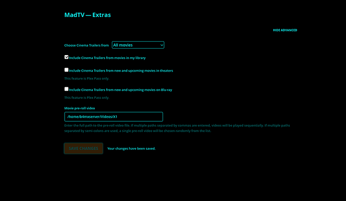

Preroll Worked yesterday not today
Preroll worked yesterday not today. What happened. I now get 1001 network error. log says no streaming video or audio. Says the same thing if I try to directly play my preroll unless I remove preroll the file location under settings extra then it plays video fine but not as a preroll.
Im lost as to getting my preroll back. Any thoughts?

I dont know if this will help but I started using preroll a week ago. It worked fine until I added a ; to add a second video for random play and none worked. Then I tried to just have the 1 video I started with and I now have this going on. I just wanted to be clear so you didnt think it just started happening.

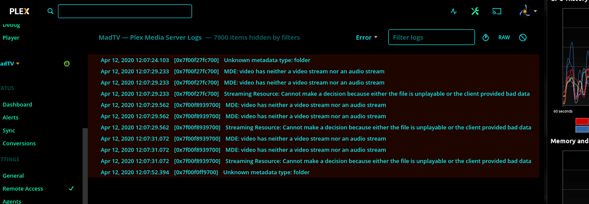

Finding a few things.
This is a bad video file.
Apr 12, 2020 12:07:29.560 [0x7f00d3fff700] DEBUG - Media Analyzer: Background analysis completed in 0.2 seconds, removing 1 IDs
Apr 12, 2020 12:07:29.562 [0x7f00f8939700] DEBUG - Streaming Resource: Attempting to create AdHoc transcode session do7dg21foej0m4x0oufpt1ap
Apr 12, 2020 12:07:29.562 [0x7f00f8939700] ERROR - MDE: video has neither a video stream nor an audio stream
Apr 12, 2020 12:07:29.562 [0x7f00f8939700] DEBUG - MDE: received PLEX_PROTOCOL_ANY from client, but could not determine best protocol. Defaulting to HTTP
Apr 12, 2020 12:07:29.562 [0x7f00f8939700] DEBUG - MDE: analyzing media item 118822
Apr 12, 2020 12:07:29.562 [0x7f00f8939700] ERROR - Streaming Resource: Cannot make a decision because either the file is unplayable or the client provided bad data
Apr 12, 2020 12:07:29.562 [0x7f00f8939700] WARN - Failed to obtain a streaming resource for transcode of key /library/metadata/97985

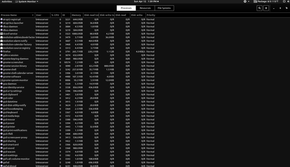

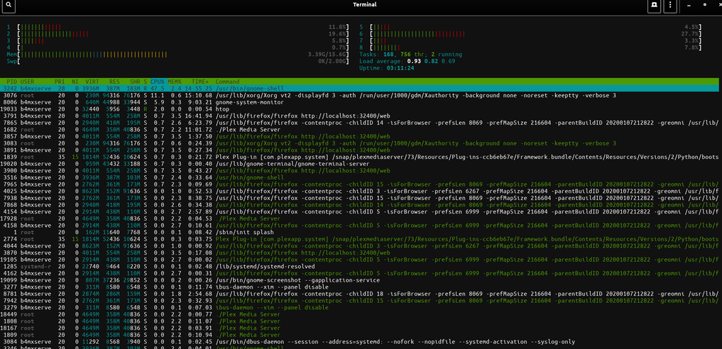

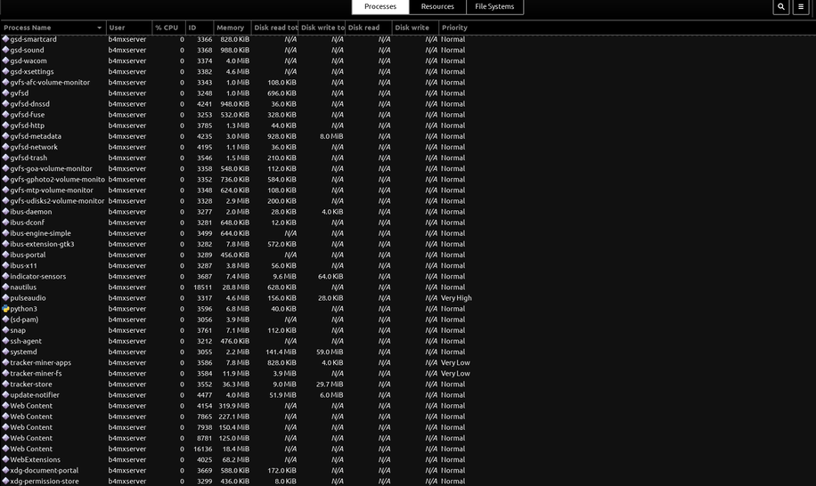

What else is running on the host?
It should be faster than this.
I have a system monitor running n thats it. screenshots to prove it
Those aren’t useful.
top (not htop) will show you the system CPU load.
its usually using around 3 to 13% unless its transcoding.

Bad video happens when it tries to play a 4 second mp4 as preroll.
If I remove the preroll address from settings then the mp4 plays like a noemal file but not as a preroll.

I am the user and Ihave permission as admin and still get these errors. Why does the video file not play as a normal file if I have its address in preroll? but work if no info is in the preroll box?
Address? it should be a local pathname.
