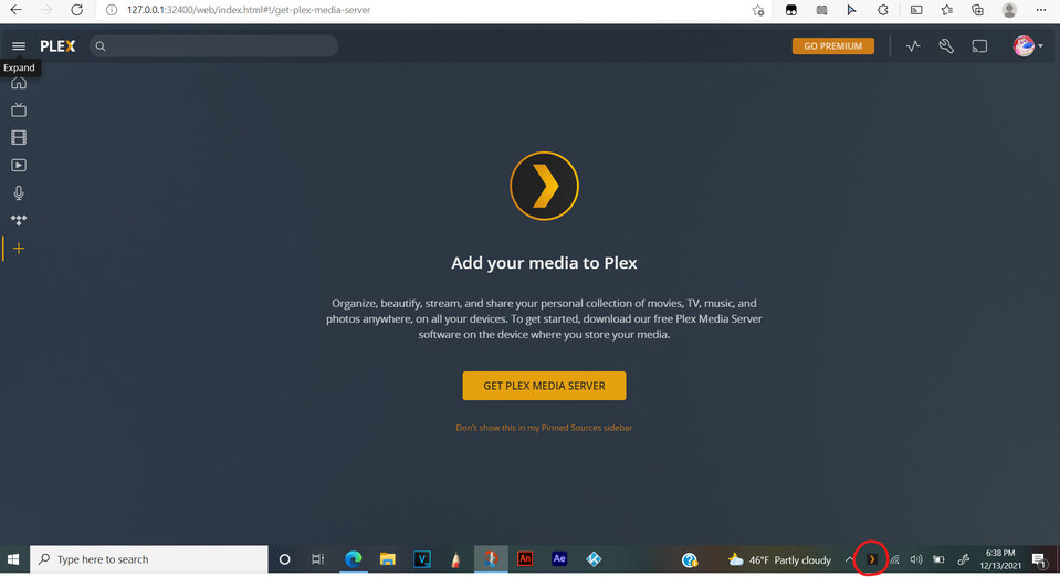

Problem : "Add your media to Plex, Get Plex Media Server” but I already have the server
So I downloaded it and when I finished everything else, I booted up my plex and I takes to the the normal home menu and I clicked on the + sign (aka add media) it still says “Add your media to Plex, Get Plex Media Server” despite me already having the server.

Or (if you have the server installed) – you might not be accessing it through the bundled version of Plex Web. This is required in order to complete the setup. You can e.g. open the Plex Media Server using http://127.0.0.1:32400/web if you’re on the same Windows machine (http://[PMS IP address]:32400/web if it’s installed on a different device inside your home network).
I’ve deleted my original plex media server and redownloaded it many times, still ending with the same results
@TaizoStimpy are you seeing the icon in the system tray? what happens when you go to http://127.0.0.1:32400/web on the same computer you installed plex to?
I have it installed and it running but nothing worked
