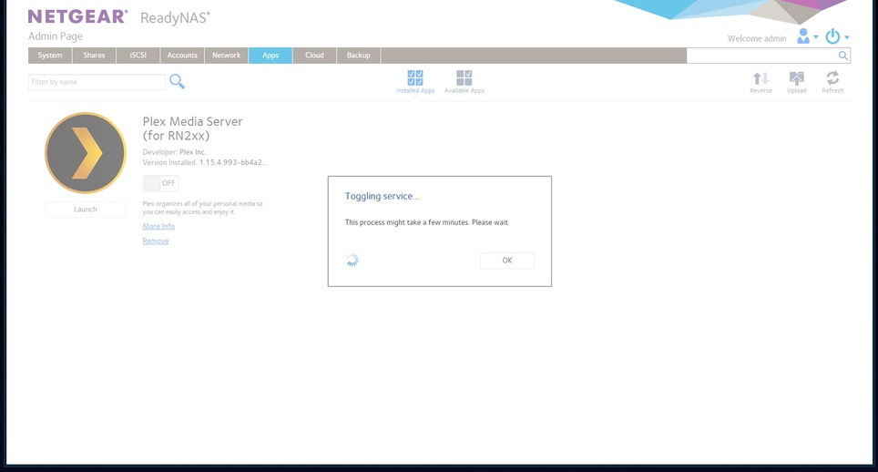

Just updated Plex and once again I can NOT turn off the server on my RN214 Readynas.
Plex Media (2.5 MB)
There’s the zip of the logs…Server runs fine so far just can’t turn it off. This also was happening with V1.15.1.791-8bec0f76c_armel.deb. The highest version I can use and still have a functional OFF button is 1.14.1.5488-cc260c476_armel.deb.
Need more info let me know.
Screenshot
