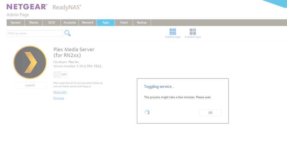

RN214 Won't turn off Plex!
Server Version#: 1.15.2.793.7822
Click on the off button for Plex and it just sits there trying to shut down Plex but never does.
Might be a good thing since if it did stop it it might not start back up…
Readynas RN214 Arm Firmware 6.9.5
