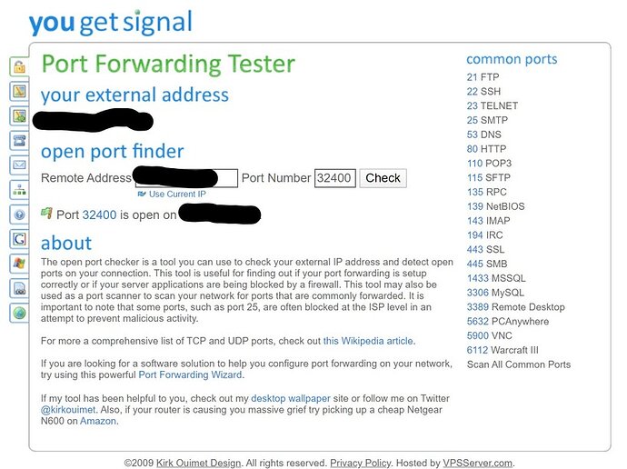

To reliably determine whether your Plex server is accessible externally, use YouGetSignal’s Port Forwarding Tester. and enter your Plex port (default 32400), or your own custom port if you have one set.
Do not use Plex’s “Remote Access” page to determine whether your server is accessible remotely, as this is exactly what is broken.

Thanks for providing this info. I just checked my server to confirm that the port forwarding is working as expected. It appears to be. I’ve blotted out my IP address, for obvious reasons. I agree with you that there is a problem with Plex’s Remote Access. This appears to add additional evidence that it may not be exclusive user error or a user device configuration issue.
I would also recommend using the external plex.direct domain name for your server to check whether the port is open as part of the port forward testing rather than using your external IP or a dnyamic DNS name, as this will validate whether remote clients are being directed to your server and can access the port.
