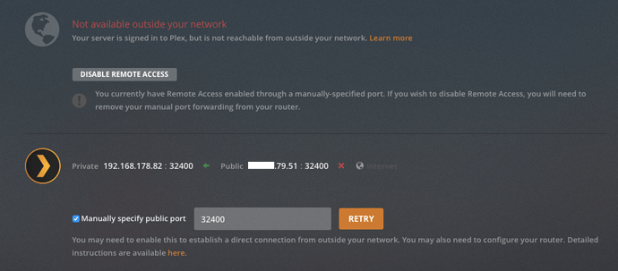

For some reason Remote access keeps disabling. Its saying that it can’t connect to the outside even though the port is open. Had this problem the last 48 hours. Anyone else experiencing this?

everything is wired, static ip reserved on DHCP port fording set 32400 internal and external. I tried putting external on a different port but no luck.
No changes to the setup.
I installed plex media server on my laptop as a test and that works, but not on the Mac mini. It usually works fine. Ive also put a freshly downloaded plex server on the mini, but no luck. I also checked if the port was open via a website. The port is definitely open.

Provide screenshots of the Server Network and Remote Access settings. Also the Mini is connected via LAN? When’s the last time it worked and has the server been restarted since then?

Have ipv6 off on both the router and the server and options like the pic?
everything is setup the same as in your screen shot.

  1. Busaman_VA supplied a screenshot and you said your settings match. In the screenshot Busaman_VA has “secure connection” set to “required”. Have you tried changing it to “preferred”?

  1. changed it to “preferred”. restarted everything. No change.

I’m having the same issue with my mac. It’s been running fine for over a year with the same network settings, but now remote access keeps disabling. The other day I restarted plex to correct the problem, but I just found clicking “enable remote access” reconnected it. Strangely clicking “apply” next to the port broke the connection again. Then clicking “enable remote access” fixed it again. It seems random.
I can verify port forwarding is working as expected because I’m currently screen sharing the mac remotely.
Version 1.15.4.919
OS Version 10.14.3
Static IP
Manual public port
Firewall has always been off
