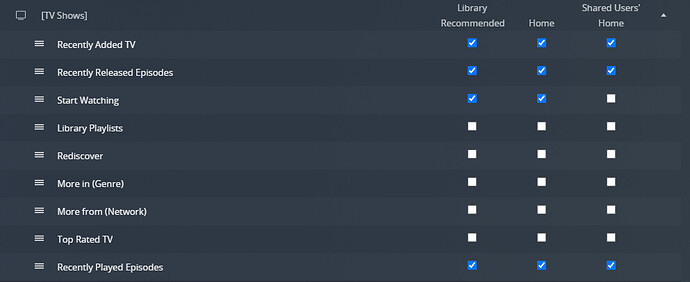

Not sure where I should post this, but I was having issues with my database running out of memory and crashing the application, but I believe I’ve found a decent workaround for the issue.
I have a fairly large library, my com.plexapp.plugins.library.db file is 980MB and com.plexapp.plugins.library.blobs.db is 2.3 GB. However, these files (Along with all other plex metadata) are placed on a 2 TB Samsung 960 PRO NVME drive, so disk access speed shouldn’t be an issue. The system is running on a 10th gen i7 processor with 64 GB of ram, so I didn’t think there are any performance bottlenecks.
After digging through my logs, I was seeing a lot of the following:
Dec 24, 2021 14:35:01.817 [3108] WARN - SLOW QUERY: It took 13640.625000 ms to retrieve 30 items.
I noticed that the extremely slow (5+ seconds) queries were only occurring when users went to the “Home” page of plex. I had enabled recommendations, ex: “More in (Genre)”, “More from (Network)” a while ago, and also had increased the settings for “Weeks to consider for Continue Watching” (10) and “Maximum number of continue watching items which will appears” (15). These changes were probably made about 6 months ago.
Additionally, I had enabled the memory logging for the database, and whenever the extremely slow (5+ second) queries happened at the same time – ex: Multiple users hitting the “Home” page at the same time, the memory usage would VERY quickly spike, going from 100 MB to 1500~MB, then crashing the application once it hit the 32 bit limit.
I modified the settings for Movies/TV Shows to disable most of the recommendations:
I also reduced the “Weeks to consider” to 4 weeks, and the “Maximum number” to 6. After making these changes, I rarely see any queries go over 50ms and the application has been crash-free for around 5 days when I was seeing 1-3 crashes every day before.

I already looked into that before my post above – I removed 7 entries that had 30k+ associations. I’ll check it again, but I haven’t had a single crash since I removed the recommendations/changed “on deck” configuration…
