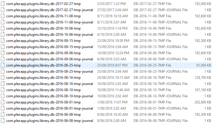

db folder:
Can I delete the 6GB db files now?

Can I also delete these old files?

Yes it should be ok
