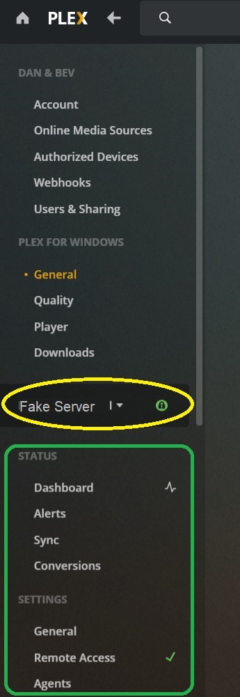

You don’t even see your server name (yellow)?
Or any of the stuff in the green outline.

Plex settings
Hi Dan_Bev,
Yes, my server name is there as well as the items in the green outline. (I don’t use remote access)
2020-12-16_12-50-42
If you click on SETTINGS General or Library do you see anything?
No. If I click on anything in that section, I see Server settings are unavailable.
Sorry to keep asking you the same thing in different ways. I’ve never seen this before. I’m sorry, I can’t help.
