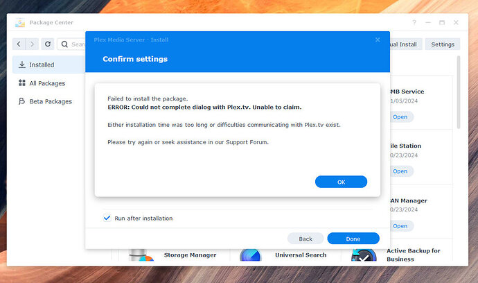

Hey Chuck, this is what I get when I try to do that.
Thanks,
Ryan
That means your Syno can’t connect out to Plex.tv
