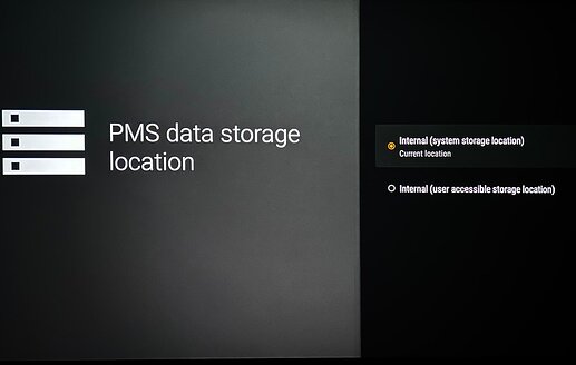

Was curious to try what you mentioned, connected my drive to Windows 11 PC, formatted it NTFS filesystem. Inserted it back into Shield, started it up - still just seeing the 2 internal locations.
Did you format as adopted storage? Or removable when you plugged it into the shield?
I’m pretty sure the user accessible storage location is the USB. That’s what the options looked like for me and my PMS is definitely using the USB (adopted storage) for database and metadata.
