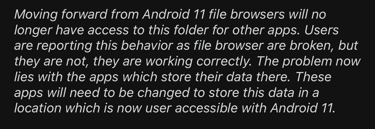

According to nvidia you can no longer access the android/data folder by design not as an error.
Therefore backup/restore is no longer possible until plex change the storage location for data.
Can anyone else confirm this - For me android/data is reporting as inaccessible both locally and over the network. (My usb drive is formatted as adopted storage).

Yes…same here… still trying to recover pms. I will try to leave the usb pen as normal storage and place the pms db there…and leave it there to allow regular backups… this until plex changes the default path in internal storage
I can only see the backup directory locally, it’s not visible over the network but I can still backup (but it’s a pain). However. It’s useless if Plex don’t change things to allow you to restore the backup, double sigh.
