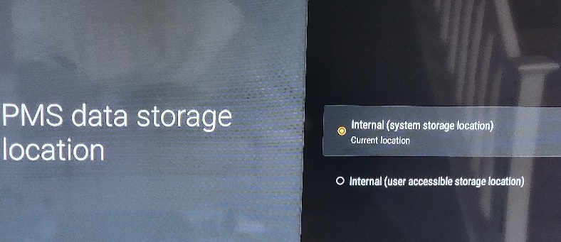

On Plex setting, by uninstall & reinstall, now I see Plex media server button (v1.25.3.5385) but don’t see storage option button next to it.

If you uninstalled and reinstalled, then you have a new server. You need to go through the first run setup again. You won’t see the option move the data until after PMS is setup.

However, it seems like it doesn’t read my external 2TB SSD so I cannot get my library back.
Do you see the drive from the Shield settings? The Plex app should see whatever the OS sees.
Yes it shows on Shield setting but not on Plex setting.

The second choice, Internal (user accessible storage location) is external storage if you formatted as Adopted Storage. I was able to move my database there with no issues.

hmmm…I chose the second choice Internal (user accessible storage location) but still not reading my external SSD.
