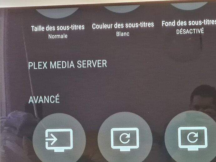

So i also received hotfix 3 and installed it. Then in Plex client settings I found Plex media server settings and stop it then run it. Everything is working fine
Oh OK. I’ll do that.
