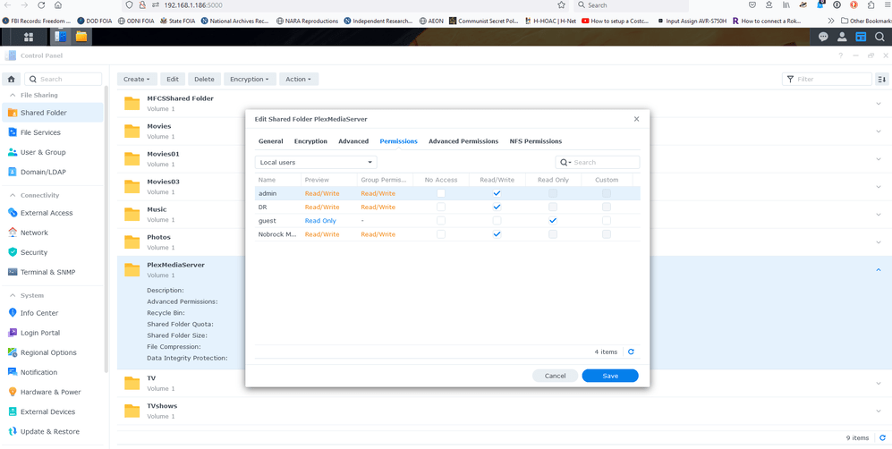

Thanks Chuck PA: here is what I see so you can me if I understand it right.
I just don’t get the problem. I’m sure it is something simple (probably that I did) but I just don’t see it. Please help I’ve spent over a month trying to work this out. I’m willing to go back to the beginning, I just want to get this problem resolved so I can enjoy all the capabilities of Plex.
You shouldn’t have to mess with the PlexMediaServer share. Plex is using that to store its database, media assets etc. – none of your media belongs there (last I checked there’s a lot of files with titles in different languages stating that).
Based on your initial post and ChuckPa’s link, you’ll need to fix permissions for the share that contains your media, e.g. Movies, Movies01, Movies03, TV and/or TVshows. You’ll need to add a permission for PlexMediaServer – that’s a system user and probably not listed under Local Users (see the support article posted by ChuckPa on the full procedure).

Reiterating what Tom write:
The PlexMediaServer shared folder is for the app (me) to use.
You can put media anywhere else on the NAS you want except there.
If you try to play with the shared folder, DSM will slap you and PMS will fail.
DSM 7 took away all the privileges we used to have on DSM 6.
This means that if you break something, the app/installer is powerless to fix it (which it used to silently do for you)
