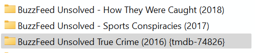

Naming should be correct:

Thank you for your reply but I tried it already. No luck.
“BuzzFeed Unsolved True Crime (2016) {tvdb-364311}”

You could try BuzzFeed Unsolved True Crime (2016) {tmdb-74826} and see if that helps get it matched correctly. Otherwise we’ll need to wait for my report on tmdb to be fixed.
I just tried that and still no luck.
