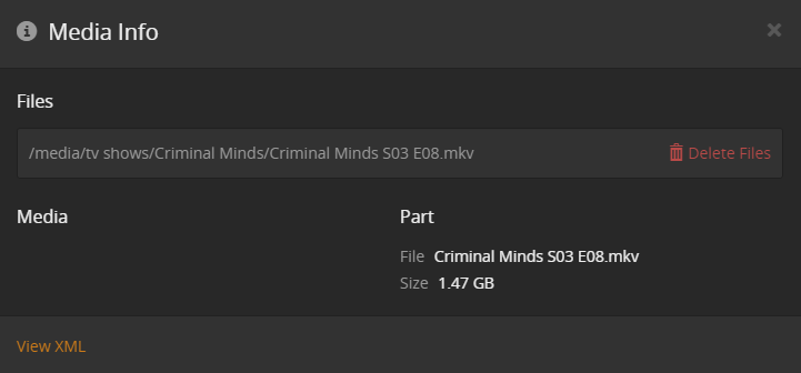

I’ve uploaded 4 seasons of Criminal minds, and have a single episode that’s erroring out with an ‘s1001’ error when trying to play it. The file plays on the host if I remote in and play via VLC.
When looking at the file info via the web app, it appears the media info is missing. Is there a way to force that to generate? I’ve already deleted and reloaded that episode, re-ripped it, etc.

No dice. Did the plex dance, and media data is still showing empty. Plex won’t play it, even though the host can.

I tried the way you have it and at first, I got a “something went wrong” message for the whole library. Finally, the show populated but then under the media info it took forever to load the info
It just said “loading….”
I took the show out, closed that space and it added it again. Everything scanned and loaded immediately
I’ll update naming convention for the collection - thanks for that.
I saw this in the logs:
Oct 14, 2022 11:49:36.125 [0x7fd814b1b808] DEBUG - Analyzing media parts for item 15571 (Lucky): 37059
Oct 14, 2022 11:49:36.126 [0x7fd814b1b808] DEBUG - [ID 37062] Media part analysis: /media/tv shows/Criminal Minds/Criminal Minds S03 E08.mkv
Oct 14, 2022 11:49:36.126 [0x7fd814b1b808] DEBUG - [MI] Opening input file: "/media/tv shows/Criminal Minds/Criminal Minds S03 E08.mkv"
Oct 14, 2022 11:49:36.126 [0x7fd814b1b808] DEBUG - [FFMPEG] - Opening '/media/tv shows/Criminal Minds/Criminal Minds S03 E08.mkv' for reading
Oct 14, 2022 11:49:36.126 [0x7fd814b1b808] DEBUG - [FFMPEG] - Setting default whitelist 'file,crypto,data'
Oct 14, 2022 11:49:37.264 [0x7fd814b1b808] ERROR - Exception analyzing media file '/media/tv shows/Criminal Minds/Criminal Minds S03 E08.mkv' (Could not parse /media/tv shows/Criminal Minds/Criminal Minds S03 E08.mkv (error=-1094995529): Invalid data found when processing input)
Oct 14, 2022 11:49:37.264 [0x7fd814b1b808] ERROR - Failed to successfully analyze part 37062.

I’m stumped. At this point, I’d run it through handbrake, see if a re-encode might fix some un-detected video errors.
Does anyone know if VLC might be detecting and working around video corruptions? If so, is there a log the OP could look at to see this happening? I’d wager VLC is more adept at file error handling than Plex is.
Lastly… I dunno, permissions? What system is the server on?
You can consider VLC a big media file “sewage plant”. You can send in sh*t and it will still play something in many cases.
Plex is not that robust.
If you are after a player which fails when Plex fails too, try MPC-HC.
Okay y’all - thanks for the help and suggestions.
The fix ended up being a re-rip from another dvd player. (I think) I also named the episode without a gap between season and episode, and did the plex dance as prescribed.
Crisis averted :slight_smile:
